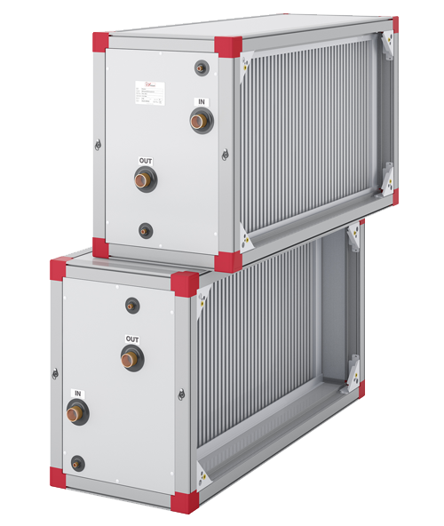

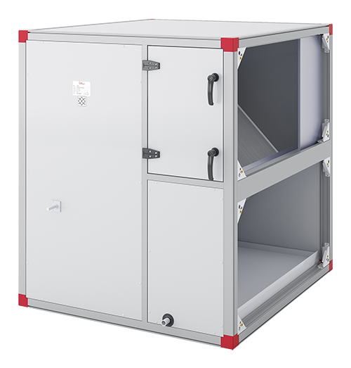

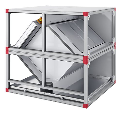

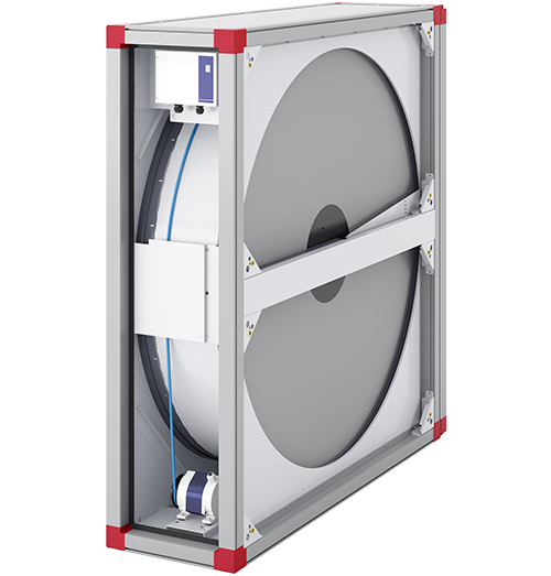

    Counter-flow exchanger
    • Highly efficient heat recovery unit with a dry temperature efficiency of up to 85%
    • Patented defrosting technology – ODS
    • No risk of odour transfer
    • Specially adapted for blocks of flats
    Rotary heat exchangers
    • Highly efficient heat recovery unit with a dry temperature efficiency of up to 87%
    • For each aggregate size, there are four variants of rotor foil spacing for optimised heat recovery and life cycle costs, LCC
    • Available with hygroscopic surface for improved cooling recovery
    Plate heat exchanger
    • A complete unit which uses heat transfer according to the air-air principle
    • Available in various designs for optimal efficiency
    Coil recovery
    • To optimise recovery using liquid-coupled coils, a number of different versions are available
    • Heat recovery coils are suitable for use when the supply air and extract air systems are separate or it is important to prevent leakage between the supply air and extract air
    Ссылки на каталоги и сайты.
